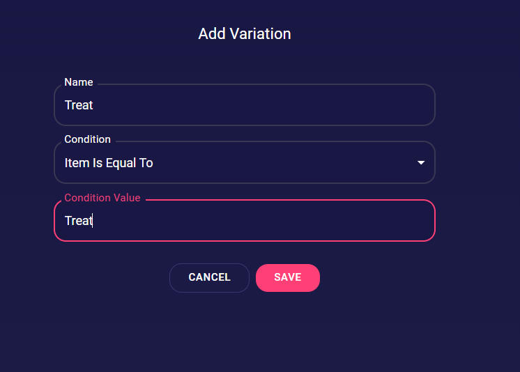

This posibility has been added in Lumia Stream 9.1.0 Beta , on the Lumia → Spin Wheel Winner alert you now can have variations for the item is equal to
