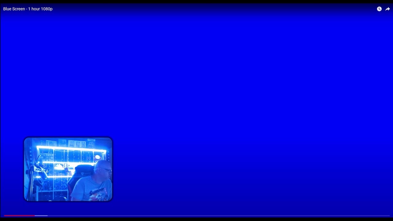

I made a little video for you to assure you I am not searching for excuses :slight_smile: I used the same settings you show on your screenshot. Tell me when I changed the mode by the brightness of my lights.
